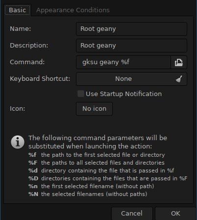

Their is a great list of Thunar configure custom actions on the site below..
https://docs.xfce.org/xfce/thunar/custom-actions
Open a root Thunar here = gksu thunar %f Appearance Conditions= Directories
I have seen people complain their new custom actions don't work all because they forgot to add an entry in the Appearance Conditions tab..and or have not installed gksu ..
Hope the screenshots are not to big Sorry if this is the case..
