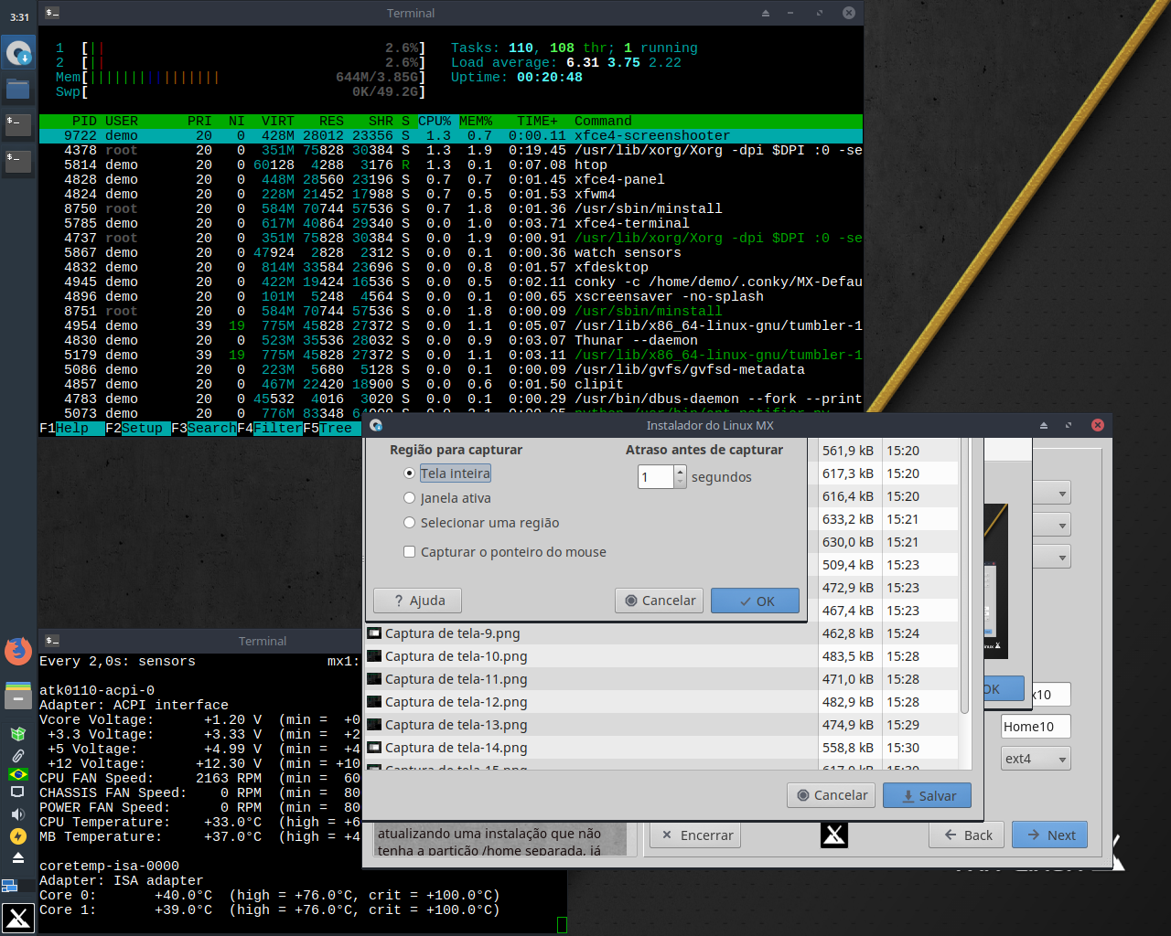

Well, I did refer this, at OP's 2nd paragraph:
whatever window or section of a window was floating over the installer window would leave an imprint of itself inside the installer
After select partitions and click "Next", Installer's window doesn't refresh any more. If any other window (e.g. screenshot) covers it, it remains for ever.
Note that I had previously formated these partitions, so it was not needed the Installer to call it at this point (I guess).
I have attached a PrintScreen showing pieces of 3 or 4 windows that remain over Installer's window.
When I said "graphical" Installer, I just meant to distinguish it from "cli-installer".
F6 Options at Boot Menu before Live session refers to #2 above:
The problem is almost certainly caused by the fact that your video card is poorly supported by the nouveau driver.
Using <F6> at the boot screen to select "Safe Video" should allow installation, after which you can install the proprietary nvidia driver using MX Tools
At #3 above:
I gave this a try. The video is certainly in a lower quality now, but sadly it did not fix the issue with the installer.
Even giving a try to all F6 options, I couldn't go after this point.
The issue has not been solved to me, event after a system upgrade in 1 (or+) of those 6 or 8 Live sessions.
What finally allowed to install, was to use "cli-installer" in a Terminal window.

Thanks you for giving me a better picture of you situation.
Remaing question not yet clear to me is:
1 Would running the graphical mx-installer allow you to install having no other application-window open?
2 If you had already prepared the partions, e.g. with gparted, before
you call the mx-installer would run the installer ok, without to manually start partioning
from the installer and again without any other open window?
Thanks

fehlix wrote:
Wed Jun 13, 2018 3:07 pm
Thanks
fehlix,
1) I didn't try without any other app-window open, so I cannot tell about it.
2) I really did try with previously formated & labeled partitions, but when I clicke "Next" the Installer's window hangs.
Note that I tryed 6 or 8 times, so it's difficult to say exactly what I did in each o them, unless I would make a complete study.
But the same Installer worked fine in Live antiX, later, in the same day.

the mx-installer was updated with things that got into the antiX installer after the may iso was released, just so everyone knows. They have both been updated now, but up through about 2 weeks ago they were not the same as the new installer got into antiX before we put it in MX repo. They looked the same in the gui, but they were not exactly the same on the backend.

Byteria wrote:
Wed Jun 13, 2018 3:43 pm
Can you remember on which window you clicked "Next" and the installed hangs:
Here the window-sequence as I see it, with having already partions in place prepared.
0. "Terms of Use" and keyboard Settings
1a. Choose disk for installation / 1c. Custom install an existing partition
2. Choose Partition
-> Now a popo-up "OK formating partiton?"
3. Installing in progress : "Copying new system..."
4 Select Boot Method : Install GRUB for Linux ... ->MBR
-> Now PopUp "OK Install Grub bootloader on sda"
-> PopUp Please wait till grub is installed ....
5. Computer Network names
6 Localization Defaults
7 Default User Account
8 Reminders
-> Finish -> Do you want to reboot...
If you do install the next time, would you mind to start the installer from within
a terminal command line with this command:
sudo -E env LANG=en_US.UTF-8 /usr/sbin/minstall
Within the terminal window you will see the actuall stepp performed.
This migth help us to identify the stepp the install stopped for you.
Below an exampel of in installation I just made:

fehlix wrote:
Wed Jun 13, 2018 4:17 pm
2. Choose Partition
8 Reminders
:snail:
Thanks for your cooperations
fehlix
the last steps were these:
2. Choose Partition
After click "Next" in (2), no more reaction and no more refresh within Installer's window.
This happened a all times, in all Live sessions I tryed, with different options.
But I will download the newest ISO and will do as you proposed, next days, and copy here the infos you said.
Note: - The cli-installer worked fine, this week, and now Plasma 5 KDE is almost fine too (Image below). Test will be made with other partitions.
